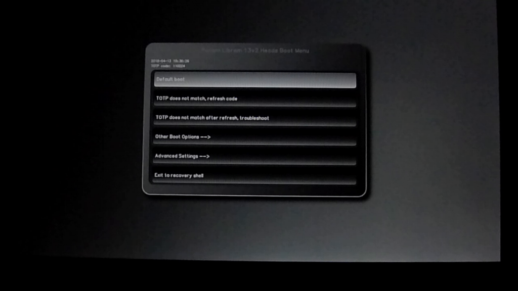

Step Three: Detect Tampering
When the system reboots, it returns back to the main Heads boot screen. First I hit Enter to select the default boot option but this time when Heads scans all of the files in /boot, it detects that grub.cfg has been changed! Along with the warning, I also get the option to re-sign all of the files in /boot. This option exists because there are a number of perfectly legitimate reasons why your grub.cfg, initrd, kernel, or other /boot files might change either because you edited them yourself or you updated software that changed them. Otherwise if you don’t want to re-sign files you can return to the main menu.
Tampering detected!
Tampering detected!
If you choose to re-sign all of the files, you will get an additional warning screen that explains what Heads is about to do and another chance to exit out to the main menu. If you did choose to re-sign all of the files you would then insert a USB GPG smart card that held your private keys so you could re-sign the Heads configuration files in /boot.
Since I knew that I didn’t want to keep that “hacked” grub.cfg file, instead of signing the files I returned to the main menu. By default Heads used to error out to a recovery shell if it detected a file was tampered with. The assumption is that the expert user could then investigate and remedy the problem from within that shell. If you aren’t an expert user in this situation you might not know how to recover and would end up being locked out of your computer!

Heads Boot Selection Menu
In each of the most common workflows, we’ve replaced the console output with an easier-to-use menu that also provides a bit more explanation on what’s happening if something goes wrong. For the most part the average user will just verify the TOTP code and then hit Enter to boot their system so in that way it’s not much different from a standard GRUB boot screen. These extra menus come in only if the user ever needs to deviate from the default and select a different kernel, generate a new TOTP code, or do other maintenance within Heads.
