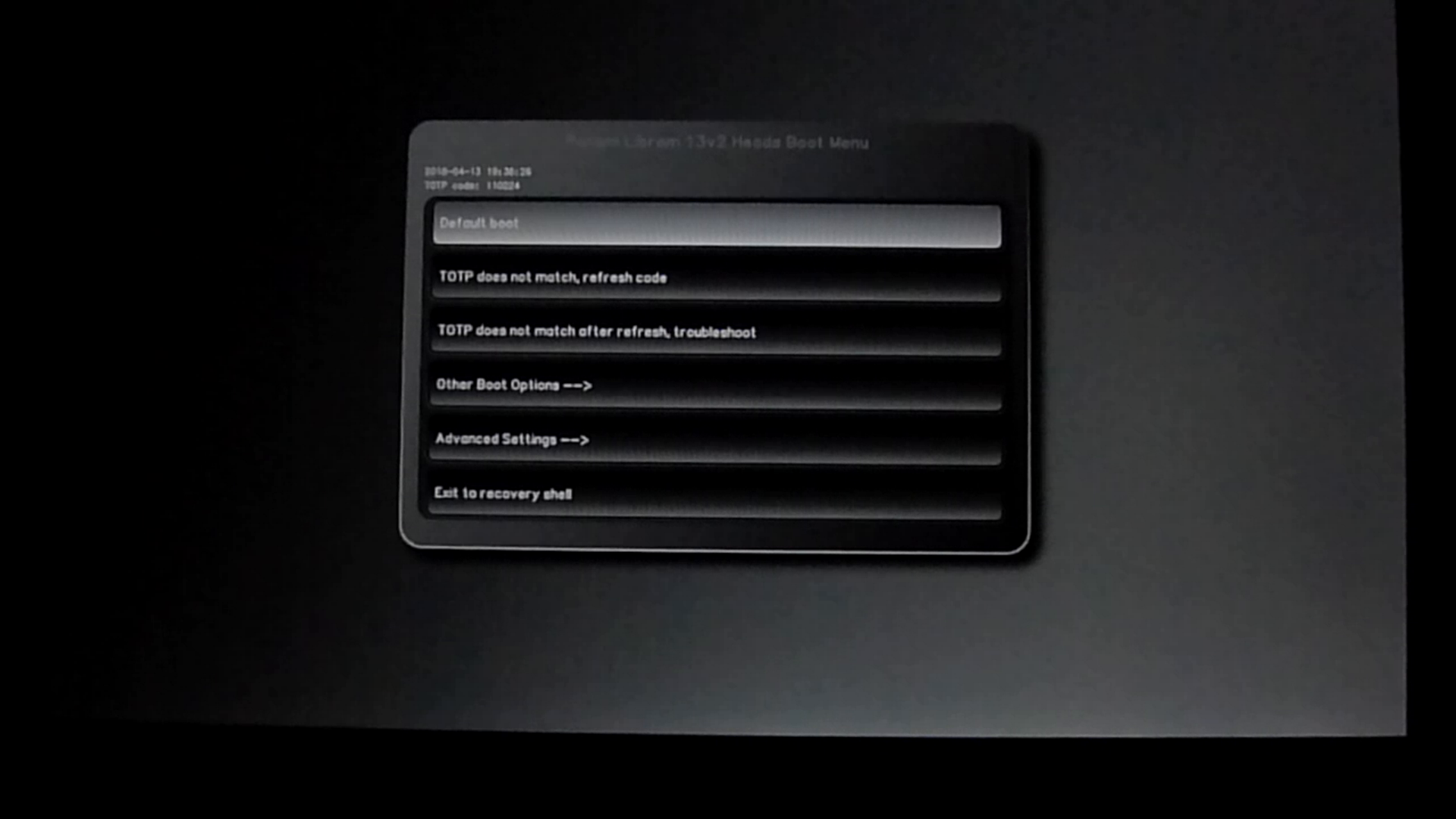

The normal boot process for a computer that uses Heads is much like with any other computer, at least from a user experience standpoint. Like with other computers, you can bring up a full menu of different items to boot, but you can also pick one to set as your default. Once you set a boot option as a default, at boot time you can just press Enter and it will boot into your operating system just like with any other system.
Default Heads Boot Menu
Unlike with other systems, Heads is providing extra levels of security during the boot process. At that default boot screen, you will see a 6-digit number above the menu options. That is a TOTP (Time-based One Time Password) code that Heads uses to prove to you that it hasn’t been tampered with and can be trusted. If you’ve ever used a TOTP code in the past, normally it’s so you can authenticate yourself to a website using Two-Factor Authentication. In this case it’s the reverse: the computer (specifically Heads) is authenticating itself to you! If that code matches the code on your phone, you know it’s safe to proceed.
Once you hit Enter during a normal boot, Heads then verifies the signatures of all of its configuration files stored in /boot based on the copy of your public GPG key it has within it. These configuration files include a file that contains sha256 checksums for the rest of the files in /boot. Once it verifies your signature for that file, Heads can trust it hasn’t been modified so it uses it to make sure the rest of the files in /boot haven’t changed. Since all of them match, they weren’t tampered with so Heads proceeds with the boot process.

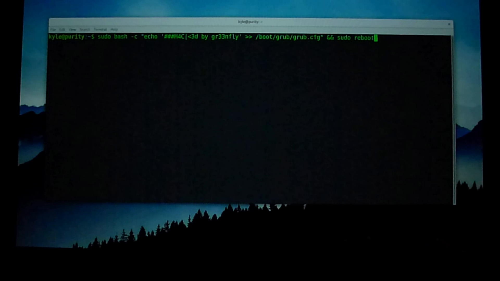

Step Two: Hack The Computer
Hacking grub.cfg
Hacking grub.cfg
Once the computer boots, I put my black hat on and “hack” my computer by defacing my /boot/grub/grub.cfg file with a comment. This is a benign hack for demonstration purposes, but the attacker could have just as easily modified grub.cfg to boot from an older kernel on your system that has a known security vulnerability, added a single user mode, or otherwise altered the boot process to make it easier to launch another attack.
An attack that changes a plain text configuration file leaves a trail that might be easier for a user to detect if they happened to edit the file themselves. A more sophisticated hacker would put a back door into your default initrd file (the initial file system your kernel uses when it boots) or even replace your kernel with a compromised version. Both of these kinds of attacks are almost impossible to detect without a system like Heads. Because all of these files are stored in /boot, and Heads checks all of them, it is able to detect all of these types of tampering.

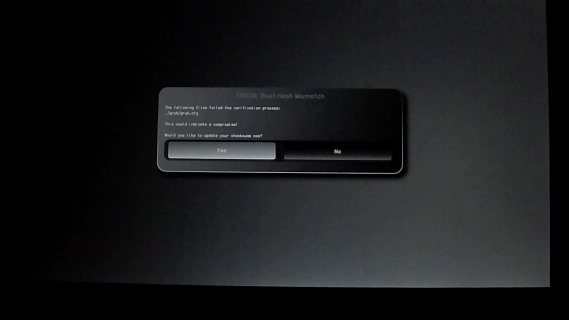

Step Three: Detect Tampering
When the system reboots, it returns back to the main Heads boot screen. First I hit Enter to select the default boot option but this time when Heads scans all of the files in /boot, it detects that grub.cfg has been changed! Along with the warning, I also get the option to re-sign all of the files in /boot. This option exists because there are a number of perfectly legitimate reasons why your grub.cfg, initrd, kernel, or other /boot files might change either because you edited them yourself or you updated software that changed them. Otherwise if you don’t want to re-sign files you can return to the main menu.
Tampering detected!
Tampering detected!
If you choose to re-sign all of the files, you will get an additional warning screen that explains what Heads is about to do and another chance to exit out to the main menu. If you did choose to re-sign all of the files you would then insert a USB GPG smart card that held your private keys so you could re-sign the Heads configuration files in /boot.

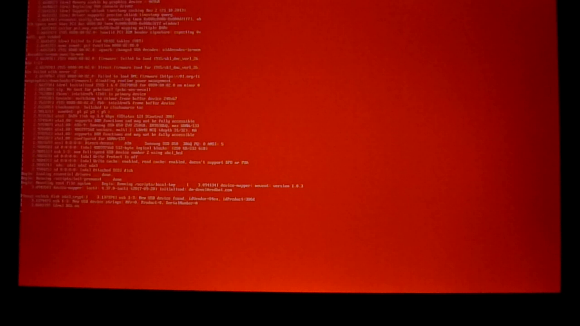

Since I knew that I didn’t want to keep that “hacked” grub.cfg file, instead of signing the files I returned to the main menu. By default Heads used to error out to a recovery shell if it detected a file was tampered with. The assumption is that the expert user could then investigate and remedy the problem from within that shell. If you aren’t an expert user in this situation you might not know how to recover and would end up being locked out of your computer!
We understand that there are a number of situations where a user might legitimately or accidentally change files in /boot and while it’s not advisable to boot into a system that is actually tampered with by an attacker (because among other reasons, an attacker might be able to get your disk encryption or login passwords), we also don’t want to lock you out. We’ve added an “insecure boot mode” to Heads for these circumstances. When you select that option, Heads will ignore any tamper warnings and present you with a GRUB-style menu of boot options. You can then select a boot option and Heads will boot into your system. To make sure you know that this is an unsafe option, in addition to the warnings in the user interface, we also disable the splash screen and change the console to have a red background.
Insecure boot mode
Insecure boot mode
